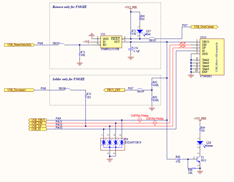

I have an stm32f303cbt6 design (see image below) connected to an hub(USB2533) and an adum for isolation, i'm trying to run a USB device CDC example by creating a new project in the Stm32CubeIDE using device tool configuration.

Hi @maac
It seems USB root hub does not set address to your device. You need to ensure that the STM32 and the USB hub are properly powered.
Follow the recommendations in the schematics provided in Nucleo F303
Provide USB traffic so that we can help you investigate further. In your case, using USBPcap in Wireshark could be helpful.
2024-11-18 3:30 AM
As i said before, the current fw is a Vendor Specific device and it's running(at least it's detected by Windows and the PC software), So i don't think there is a problem in the design. I'm looking to change or get better(i don't know for the moment) that USB fw because there is no documentation about, and i'm trying to run examples first. I can't sniff the communication cause the USB is not detected as i said.

2024-12-13 3:33 AM
I'm back to know if you have any idea why a simple USB example can't work looking the schematics i sent knowing that there is a USB fw working on it that i want to change.
