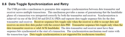

1. The current HAL library (stm32f4xx_hal_hcd.c) performs a data toggle on every XFRC interrupt for all endpoint types, including Isochronous. I didn't change that functionality. If you believe that data toggling should not happen for Isochronous then you should change the HAL to no longer perform data toggling for Isochronous.
2. USB protocol states that a receive is considered complete if:
I noticed there were data toggle errors (DTERR) on the port causing data loss whenever the number of bytes received was an even multiple of the endpoint max packet size. This is because a ZLP was received by the HAL and the HAL was not performing a data toggle. My update essentially adds a data toggle for this special case.
It's possible that there are USB devices that don't conform to the ZLP requirement and my change would then cause data toggle errors for those devices. But for my device I didn't want the errors and the data loss was not acceptable.
Perhaps there is a more elegant solution that would allow the driver that sits on top of the HAL to manage the data toggling. Currently, the HAL is managing it so I modified the HAL.
