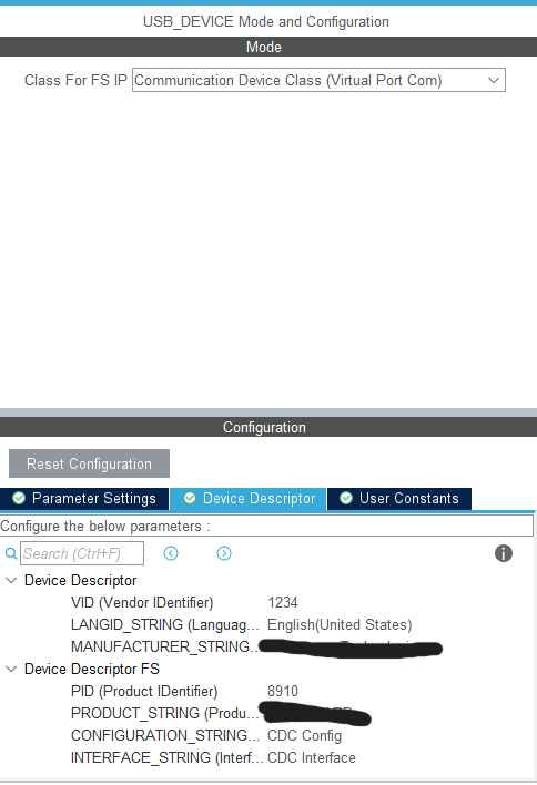

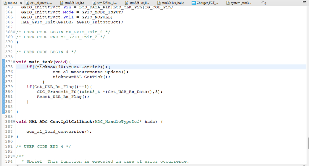

Right now i am facing the issue on detection USB.I am attaching snap shots of the my USB configuration.
USB port not shown after powering up the board. i am doing some basic thing like on receiving via USB in RX interrupt function of USB i set one flag that will used in main function for further process.
Help Me if anyone knows the issue, i stuck here since 2 days.

If there is a need to increase stack and heap size, make them at least 1024 bytes or more. Pullup resistor is required only with F1 series. The built-in USB bootloader is not present in F103, so some of the information you provide is false or at least incomplete.
2023-11-07 4:11 AM - edited 2023-11-07 4:12 AM

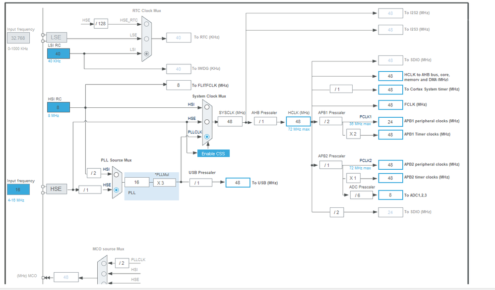

Check the USB cable and the operation/frequency of quartz oscillator. Some versions of USB stack may require increased stack or heap size - set both to 2048 just in case. And, as I wrote many times in the past, calling USB Transmit from the main loop will sooner or later hang the USB stack, but it's another story - deal with it after the device is detected.

Hi gbm,
thank you for response ,As you suggest me i check the oscillator frequency and it is 16mhz. i will let you know after changing heap and stack size to 2048.

No detection despite of changing the buffer size to 2048 Bytes

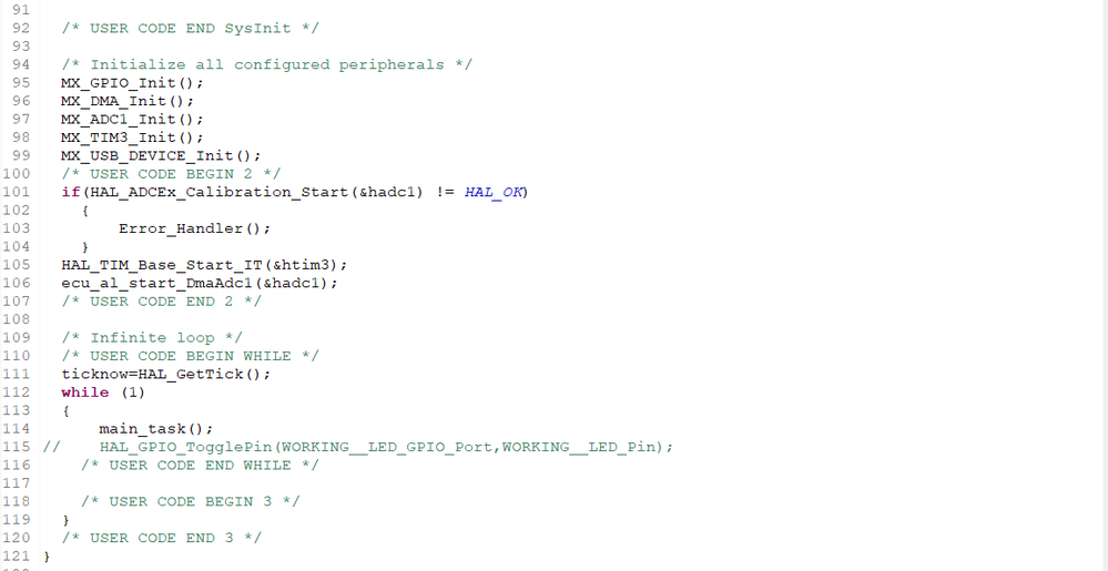

So maybe you should use The Force... I mean the debugger. Comment out your ecu-related calls, leaving only USB initialization, then check what happens.
My wild guess: continuous ADC conversion causes continuous ADC interrupts consuming all the CPU time with no time left for any other processing.

One cannot just call functions like CDC_Transmit_FS() from this USB stack:

Thanks gbm ,i tried by creating test project in which i run USB only and find the same as before. other then that i have same project with stm32f0 series there USB works fine.is there any issue with the stm32 SDK?

can you explain me more about what your point of view because i am not able to understand properly i am slightly new to USB

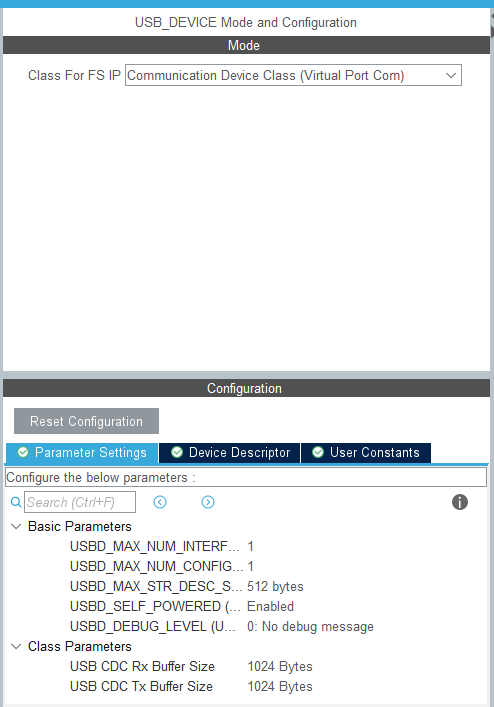

Increase the stack and heap size in CubeMX project settings. The RX and TX buffer size settings in CubeMX are pure nonsense - only 64 bytes of RX buffer are ever used and the TX buffer is not used at all.
