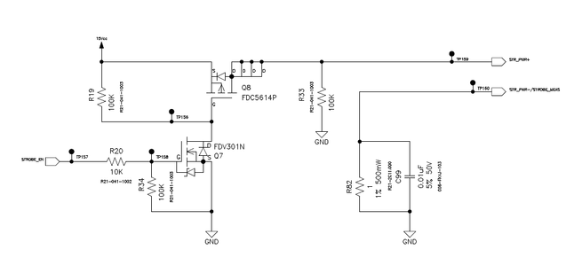

Here is a snipped of the relevant portion of the schematic:
The ADC is being used to measure the current drawn by an attached device (between the STR_PWR+ and STR_PWR- pins) via a 1ohm resistor. The ADC pin is connected directly to the STROBE_MEAS pin (which is the negative terminal of the attached device).

I 'd recommend to use op-amp, DS says uCPU has "• 2x operational amplifiers with built-in PGA" but for different reason than impedance buffering - not required with just 1 Ohm. Reason is safety - 15V demands at least 15 kOhm resistor in series with analog inputs to keep injected current in any case below 1 mA, otheways uCPU or just ADC could be easily destroyed by loading device malfunctioning or during transition state - charging/ discharging etc.
