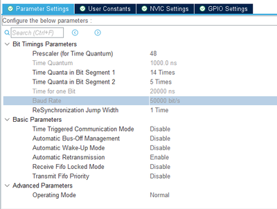

Below is the setting and the code for receiving.
    Here is parameter setting.
    Here is NVIC setting.

You have to configure correctly the filters otherwise you can't receive any message.
You can inspire from any CAN example provided in CubeF0 firmware. Example: Projects\STM32072B_EVAL\Examples\CAN\CAN_Networking\
