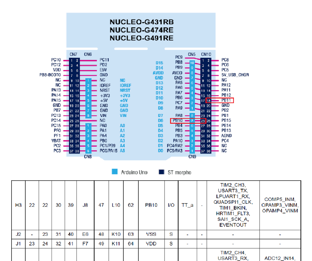

I'm working on a NUCLEO-G474RE board (using the LL libraries available on ST site), and I came across an issue, the USART3 available on the PB10 and PB11 is not working. I tried to generate the same code from the CUBEMX as well but unfortunately, no successful outcome so far. In the "User Manual" of this Nucleo board, nothing is specifically mentioned (Jumper settings) regarding the USART3 settings. On the other side, the same USART3 available on PC10, PC11 is working fine and well. As my costume-made boards are already in the fabrication process, could someone please tell me if this issue is related to the Nucleo board or the STM32G4xx series controller?
I'm attaching a code snippet and Nucleo/ Datasheet referential image.

2021-02-17 5:38 AM
So pull a schematic and trace the pin from the IC to the header.
Check you're looking at the right pins. Toggle as a GPIO, send a stream of 'U' characters as a UART, scope the pins.

2021-02-25 4:32 AM
Very strange issue! Now when I directly soldered the wires on the pins, it is working properly.
