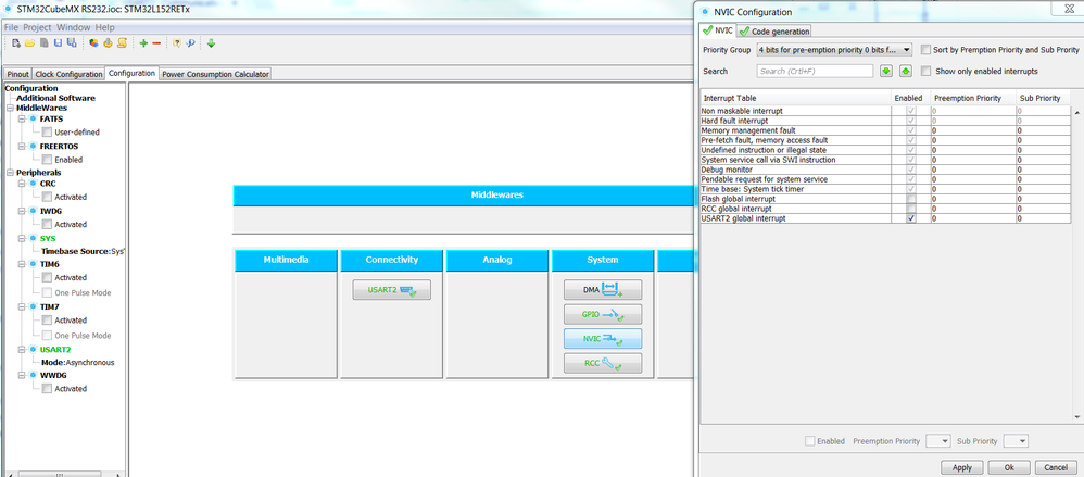

Have you enabled the NVIC for the UART in the Cube tool ?.

Without launching my code, when i open an hyperterminal (Tera term) i receive the data with the good format. so i think hardware part and configuration of uart is ok

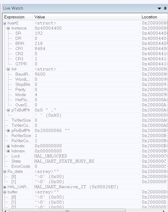

But if i check my variables buffer, RX_data... are fixed to 0. Is it normal that i don't have StopBits?
I'm a bit lost...

Using a debugger with 'live watch' and viewing peripheral register data is a 'deadly' combination.
Several registers have flag bits that get reset upon read - like interrupt flags, for instance.
