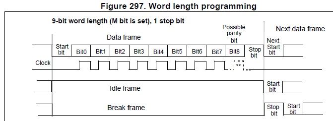

i use the IDLE interrupt of the USART to check if the packet is received.
2012-02-16 1:04 PM
Hi Erik,
I looked at that but the manual seemed to imply an 'idle' frame/characters were required from the other end (which I don't have - is it really just a quiet time with no trasmission?) and that only a single character delay in transmission would cause the interrupt. ...Laurie:{)2012-02-16 9:50 PM
you don't need a special character at the end of transmisson. if the rx lines goes to idle, then you will get the IDLE frame interrupt.
i use this feature and is working without special characters on the line2012-02-16 10:57 PM
Thanks Erik,
I'll give that a go. I expect it will be a better indicator of ''between packet'' time. Cheers ...Laurie:{)2015-08-04 7:13 PM
hi,I read the manual ,it says :''An Idle character is interpreted as an entire frame of “1�?s followed by the start bit of the next
frame which contains data (The number of “1�? ‘s will include the number of stop bits).'' ,So it needs a start bit ,i think this method cannot cause a interrut2015-08-04 8:15 PM
I read the manual ,it says :''An Idle character is interpreted as an entire frame of ?1?s followed by the start bit of the next frame which contains data (The number of ?1? ?s will include the number of stop bits).'' , So it needs a start bit, i think this method cannot cause a interrupt
The diagram however pretty much defines that the idle frame is absent a start bit, it's basically an entire symbol time with the signal high.We’re moving the ST Community to a new platform to give you a better and more reliable community experience.
