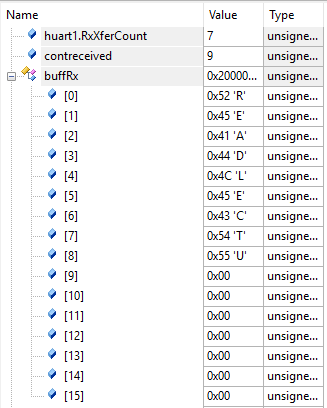

I use an 8-position buffer where I keep what we receive for USART. When I receive, if the size of the messageis less than that of the buffer, the following receipt is written below what Ialready had. How can I restart the index for this reception buffer?/**

That's what I receive first, and it's OK.

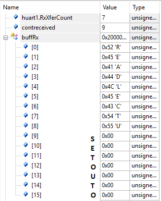

Here is the second reception,which overwrites the first.

Not sure it's overwriting as much as starting at a different part of the stream, your parsing code will need to be smarter and resynchronize with the start of the data you are looking for.
To see if it overwrites, or is new data, fill the buffer with a known pattern before each start, ie something like 0xCD
2017-07-11 4:31 AM
I added a ''resetbuffer'' in the callback, but the only thing I get is to clear the buffer after it has been filled. So what has not fit before, starts to fill the buffer again.

First I'm sending READLECTU, and later SETOUTOFF
