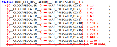

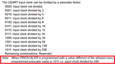

The reference manual:
Present HAL implementation uses division of 1 if the selected division is unknown: the red marked source does not match the RM?

Hello @EGi ,
Thank you for bringing this issue to our attention.
I reported internally.
Internal ticket number: 181059 (This is an internal tracking number and is not accessible or usable by customers).
Thank you.
