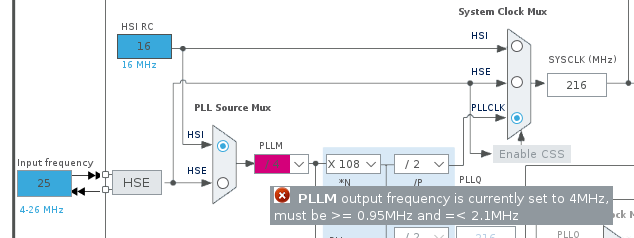

Below can find default config and my HSI config:
Default config (Using HSE):

2020-05-06 5:10 AM
Try it with PLLM=8 and PLLN=216 instead, adjust PLLSAIN too.
2020-05-11 12:00 AM
Ok, now I got:
PLLM = 8;
PLLN = 216;
PLLSAIN = 182
With these values I have fixed some issues of the GUI application running on the MCU, but USART keeps not working.
