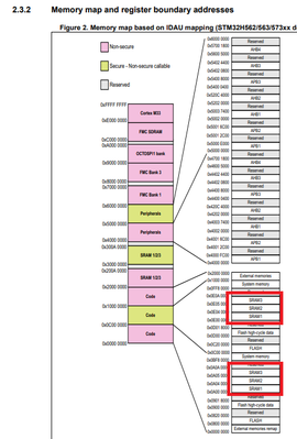

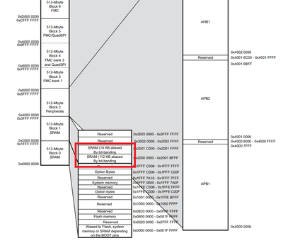

we are examining if we can apply our March-C test to the STM32H562. It is tailored to the RAM address order of the STM32F446. Unfortunately, the documentation does not seem to provide any hints here. Is there a difference in RAM address order between these two controllers?

Hello @rt33 and welcome to the community,
There is no comparison between products in term of memory mapping but you need to refer to the related product reference manual:
H562:
F446:
