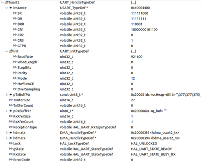

I am currently using USART6 by setting RX as interrupt, and TX as DMA in STM32F4.
The ST board mostly worked well, however, after some hours (maybe 10 hour), the RX interrupt wasn't called.
I suppose that this problem is not related to hardware or IC because it worked well after software reset,
I captured the huart information at the moment, and posted it and my code related to RX.

I have read an article about USART and I find out that IDLEIE in USART CR1 have to be set as 1 to be interrupted.
But in my case,
How do I address this issue? Would I just add a code that force to change the bit from 0 to 1 in IRQHandler?

If you want idle interrupts, use HAL_UARTEx_ReceiveToIdle functions instead.
There's nothing wrong with the code you posted.
When the error happens, pause the program and look for reasons it may have stopped. Specifically, look at ErrorCode within the huart2 structure and the state machine in general. Possibly there was a parity or framing or other error on the line, in which case you need to reset the peripheral and/or address the issue to continue.

Until now, I found that my status register was [01 1111 1000] which show that my MCU had Overrun error.
I post an SR information for someone who may experience the same issue like me.

Although I'm very late, I leave the consequence of my solution.
In my opinion, my problem looked like serial overrun.
So, I changed the serial baudrate from 921600 BPS to 115200 BPS.
After changed it, I haven't experienced that problem so far.
