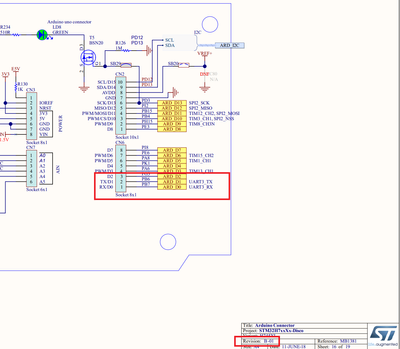

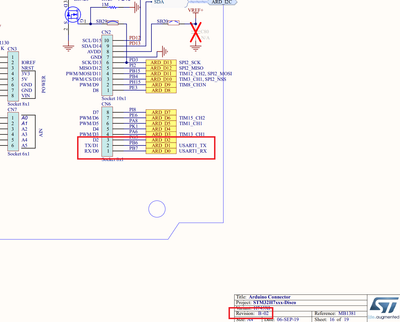

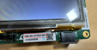

It seems the VCP connection has been changed from the board rev B01 to B02 from USART3 to USART1:
Rev B01:
Rev B02. and starting from Rev 2, USART1 is used with VCP instead of USART3:
So check the revision of your board:
If B02 or later you need to use USART1. I've attached a project where USART1 is used and Tx and Rx are looped back and the Rx callback is continuously called each character is received.
Hope that helps.

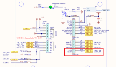

Hello @EnesUNLU and welcome to the ST community,
As you can see from the board schematic, PC6 and PC7 are not exported on the Arduino header. Tx and Rx are exported on D0/D1 (PB10/PB11) on CN6 connector:
So for now use USART3 and connect PB10/PB11 together.
PC6 and PC7 are already used by the eMMC memory:
