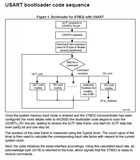

The failure occurs during the connection of the updater to the device running in bootloader mode. Here is the page from AN3155 describing the connection process:

The first two bytes sent, 0x55 and 0xAA, are received by the running 417 board, which then resets and runs code in the startup file to place the processor in bootloader mode. Then the 0x7F byte is sent to establish communication with the 417 which can now receive bootloader commands per AN3155.
