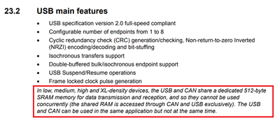

You cannot use CAN with USB at the same time on STM32F103 devices as they are sharing the same RAM.
From RM0008 / page 622:
