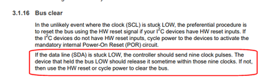

From the I2C specification:
https://www.nxp.com/docs/en/user-guide/UM10204.pdf

As an Ex-Philips guy, the clocking out of a jam method seems to be a thing people frequently miss.
Although back in the day you could get buses with devices that were capable of different speeds, and if you had slow devices one also had to consider they might get confused.

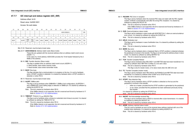

I'm not sure we are talking about the jam-requiring-pulsing here. The opening post does not imply that, although we haven't seen nor heard about the waveforms.
I'd bet this is something around Cube/HAL's ways to handle unexpected situations such as address NAK. We've heard that it does return a generic error, but maybe it then requires some specific handling to resolve the situation (an I2C reset through the enable bit, perhaps?)
I'm eager to hear what @Joe WILLIAMS finds out about this issue.
> in this case I might just need the bit to disable I2C4 in hardware to reset the AF (Acknowledge Failure) flag.
I'm not sure what is "AF (Acknowledge Failure) flag".
IMO after NACK you should see the NACKF flag to be set; the RM says how to clear it.
But if you are talking about some Cube/HAL specific flag, you should resort to Cube/HAL manual; or, if it fails to be informative enough, directly to the Cube/HAL sources - it's open source.
