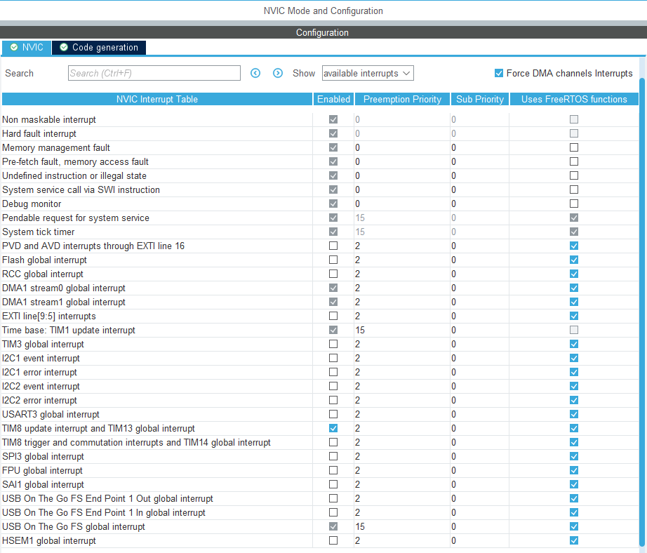

And these are my NVIC settings:
Thanks!

its late now...but in brief : your problem is int priority.
ie. i have on H743 (and now on H563 beginning) an audio player running. :)
read from SDcard or USB stick, data out with SAI /DMA circular (same you, almost); with FatFS.
when playing cd audio 44/16 , cpu load is about 3% ; with FLAC file at 96k and 32bit also no problem, cpu still under 40% load; and decoder + 2x biquad filter (double precision) needing most time here, cpu at 200MHz clock, to run cool.
so "play" with your int priorities ! all on same level is nonsense.
try: usb 4 , DMA 9+10, tim so important? if not, 12.

The SAI DMA interrupt is the only relevant interrupt. I used one timer to benchmark execution times. I disabled it just to make sure, no difference. USB completely disabled doesn't change anything either.
The file manager task has the lowest FreeRTOS priority. There are two other DSP tasks which obviously need a higher priority as these are critical for the audio processing. Those tasks receive notifications from the DMA ISR when a new sample block has been acquired. I've had the impression that disabling these two tasks makes the problem appear a little less frequently, but listing directory contents is still unreliable.

I don't understand how interrupt priorities could be the issue here. But I tried what you suggested and also tried different combinations. No success. SPI communication with the W25Q128 is not in interrupt mode. I disabled the timer, it's not needed anyways. USB enabled or completely removed makes no difference either. Also, since a lower number means higher priority, wouldn't it make more sense to keep the DMA interrupts low around 2 (= high priority) as these are the most important and time critical thing? And set the USB to a high number (= very low priority) since it is not time critical at all?

@JP_ama , ok . I just believed, it could be related to the int prio. , because this was very important in my setup.
DMA is the most important thing in runniing continuous data stream - right. but if buffers are big enough, i am using 8K int32 , every callback has up to 40ms time for sevice; so INT prio can be very low, on the other hand in this time gap data needs to be read (or write) from USB or SD, so this has to be as fast as possible - thats why USB or SD needs higher prio. (completely different than first imagined - but now obvious ).
