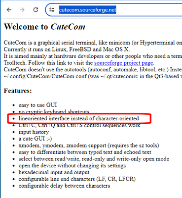

I note:
So are you sure that your code is sending in a proper format that CuteCom will recognise as a "line" ?

@mohitmg wrote:All I am doing is sending 2 byte data over UART TX and trying to sniff the data
As I said, I don't know this "CuteCom" and, therefore, don't know exactly what it means by "line-based" - but I suspect it's not the right tool for doing that.
Especially as it also says it's not "character-oriented".
