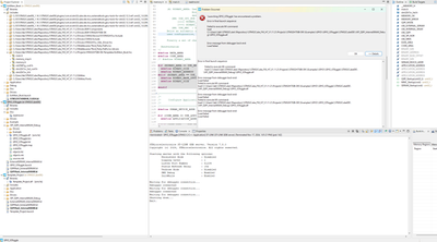

I am not sure but my development board STM32H750B-DK may have some issues and I need some help to find what it may be .
As per the readme.txt (there is very less literature that I could find on this board) , I could dump the ext_mem boot bin into the Internal flash and I did not face any issue there. I am now trying to flash the IO toggle image onto the QSPI flash present on the development board and I always face the same error. I feel that there maybe a hardware issue on the board but I could be wrong. Your help is highly appreciated.
I have attached the error image.

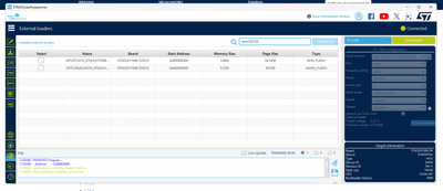

2024-11-18 12:08 PM
Thanks for your responses.
I am not sure what is my external loader supposed to be . With the version 2.17 of the programmer , I could not find the external loader for STM32H750B-DK . Which one should I choose. I tried the second one but I still could not flash the image although I could fully erase the external flash. Also, is it possible to get schematics of this board ?
2024-11-19 12:24 AM - edited 2024-11-19 12:25 AM
The NOR Flash (the first one).

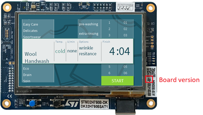

2024-11-23 12:13 AM
Can you tell me which schematic version applies to the STM32H750B-DK ? The silkscreen says MB1381B
2024-11-23 4:23 AM
You need to check that in your board :
