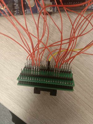

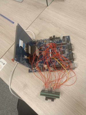

I am currently working with the STM32H743Eval2 evaluation board with an external nand flash memory "Micron MT29F2G16ABAEAWP" , and i'm trying to run the code provided in the firmware on the same memory but i get an I/O error. the same error when i debuged it without connecting the memory to the board. is there any way to verify if the the memory is connected to the board ? or is there anything else messing ?

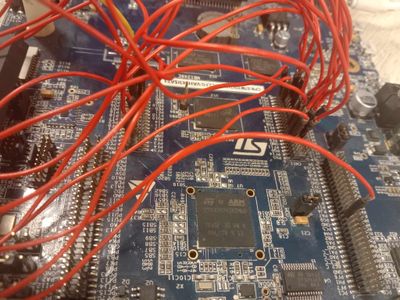

On the STM32H743 eval board, the FMC is already connected to a flash chip on the board. Won't there be a conflict?
The flying wires for high-freq signals look frightening.
