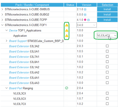

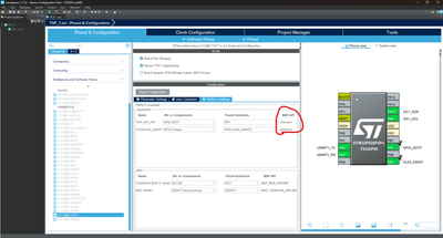

I only have an STM32F030 DEMO Board to work with, When I try to do the Pin assignments for the MCU (STM32F030F4P6), by including the software pack X-CUBE-TOF1 in simple ranging mode; the BSP APIs for the pins TOF_INT_PIN and VL53L4CX_XSHUT are unknown, Please find the attached image for your kind reference,

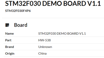

The STM32 board you are using is not a ST product.
STM32F030F4P6 - STM32F030 DEMO BOARD V1.1 | STM32-base project

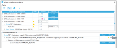

Anyway, I think I understand your issue: You may forget to select the Application and resolve the warnings by importing the BSP driver class. Please try it and let us know if it works for you, I cannot give you more support than I did on a no-ST product.
