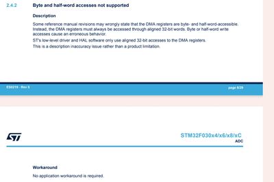

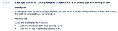

Maybe one of those 3 errata is the source of your problem.
if not, i Suggest you to do the send all the 8 bytes byte by byte using a for loop that send the byte 1 juste after receiving an acknowledge that the byte 0 was well received...

Hello. Thanks !
Maybe the third one but as far as I read, it seems the HAL_UART_TRANSMIT_DMA and HAL_UART_RECEIVE_DMA deals with uint8 and uint16. But what to set up in the CubeMX config panel.
2023-09-07 8:17 AM
You have to do exactly as sayed in the errata.
Best regards.
II
2023-09-07 11:35 PM
In the HAL file, there is
AL_StatusTypeDef HAL_UART_Transmit_DMA(UART_HandleTypeDef *huart, const uint8_t *pData, uint16_t Size)
This is 8-bits data... and there is no other suggestion than using 32-bit... but does it mean that the HAL files are wrongly written ? Because, it is written in "write access" so only when I send (TX) bytes... not at the reception (RX) as there, I do not write in the DMA registers....
Do you have example linked to this errata ?
Bye,
H
