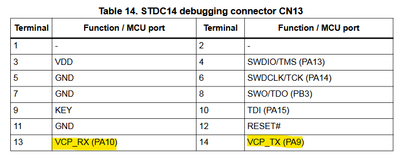

Hi @Louie88
Are you using the Virtual COM port on ST-Link connection ?
In this case, I'm not sure you are using the right PIN for RX (PB7).
Could you try PA10 instead ?
In DK manuals and schematics, I think PA9/PA10 are mentioned for VCP connection on this board.

2025-01-28 1:00 AM
Hi Guenael,
You are absolutely right. Thanks for the note. I never checked the pinouts because those were assigned by STM32CubeMX, when I enabled the USART1 for H7 CPU.
Bit I double checked it. I disable USART1 first then, the PB7 was released (form USART1). But when I enable USART1 again the STM32CubeMX always assigns PB7 instead of PA10 as RX pin. You found a bug in STM32CubeMX, I think.

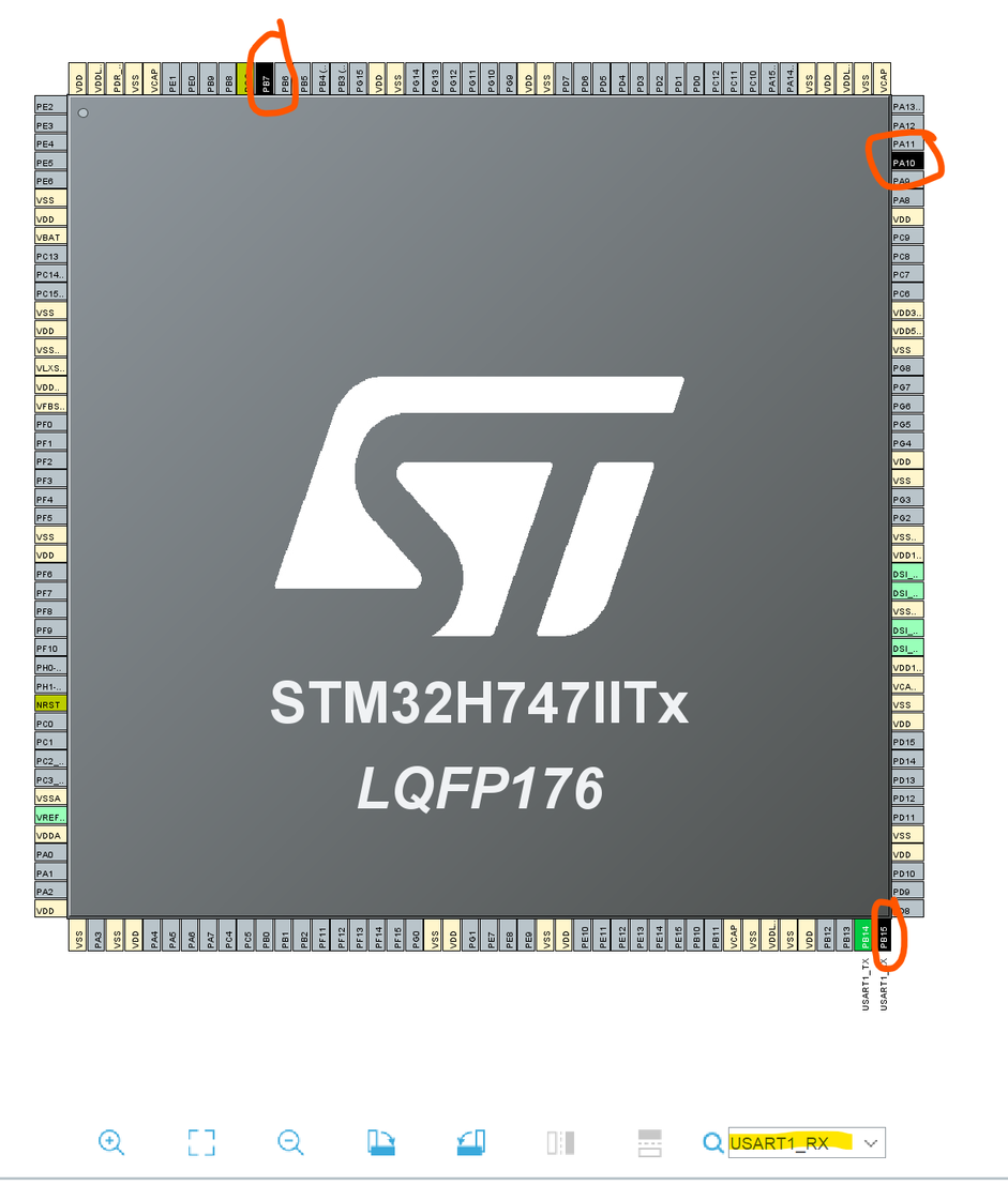

2025-01-28 2:18 AM - edited 2025-01-28 2:22 AM
That's not a bug. USART1 has 3 user selectable Rx pins, and 3 user selectable Tx pins. You just have to override what CubeMX selects when you enable USART1. So in CubeMX, left click PA9 and PA10 pins and choose USART1 Tx and Rx configuration.
Or search for it. For Rx example, you can see the 3 black pins that are available
