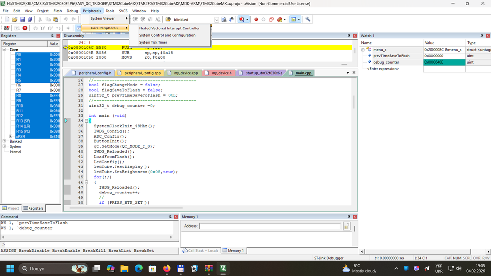

Missing Registers: Even when successfully installed, the System Viewer in Debug mode is empty. Peripheral registers (GPIO, RCC, etc.) do not appear for the STM32F030 series.

The "System Viewer" list in the "Peripherals" menu remains blank when using the default settings of the 3.1.1 pack.

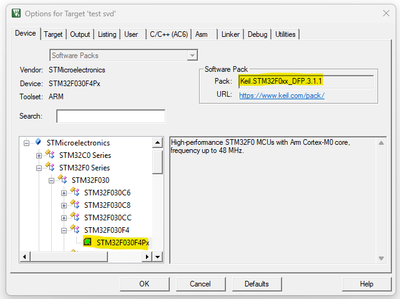

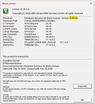

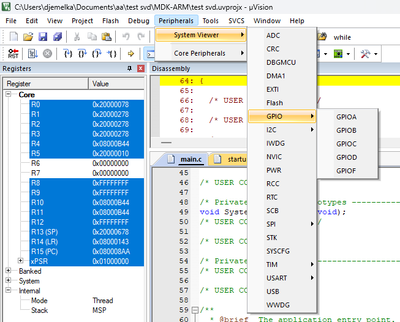

Hello @Kent;
I tested the issue with MDK KEIL version 5.38 and STMF0xx_DFP 3.1.1 version and I can see the peripherals registers as shown in the below figures:
I think the issue is related to KEIL version or KEIL installation.
Could you please try to reinstall the toolchain.

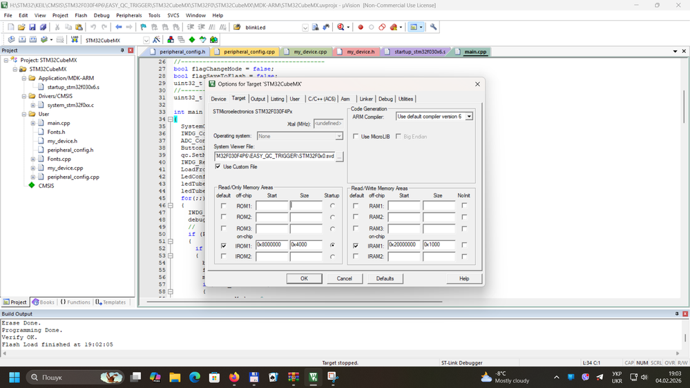

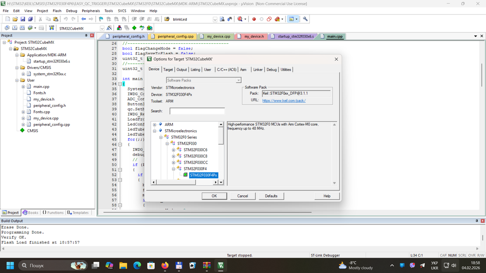

2026-02-04 9:27 AM
Hello!
Problem not solved. Peripheral registers (GPIO, RCC, etc.) do not appear for the STM32F030F4P6 series.
MDK Keil 5.38a + STM32F0xx_DFP.2.1.1 all working.
2026-02-06 4:51 AM
