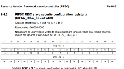

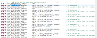

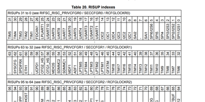

Can you please tell RIFSC->RISC_SECCFGRx how the x register has been specified in the RM0486. Is it taken up from Table 20. Because in the header file how has it been written. A bit confusing if I have to enable for another Non-RIF aware peripheral.

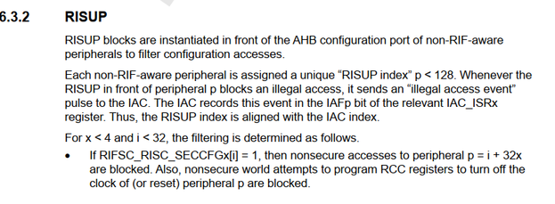

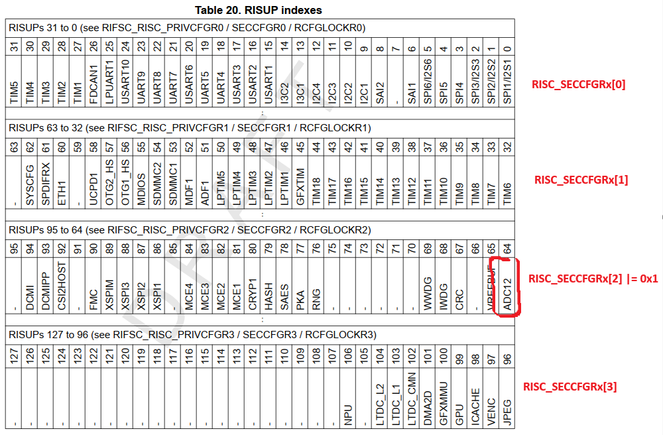

Hi @athern27
RISUP needs to be configured to allow non-secure peripheral (here GPIO PB10) to access to secure peripheral (here ADC1)
And the rules are as below:
