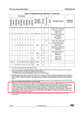

2025-06-14 2:34 AM
This is consequence of the USBC PD dead battery mechanism.
As the text says, PWR_CR3.UCPD1_DBDIS to disable this feature (don't forget to enable PWR by setting RCC_APB1ENR1.PWREN prior to this).
