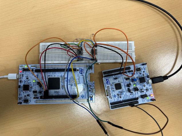

As promised, I setup two projects (in attachment) with NUCLEO-G474RE and NUCLEO-H7A3ZI-Q based on this example with some modifications (ex: using RNG to generate random data to send from both sides):
I'm using MCP2562FD transceiver.
Each time you push a key on a board, the data is received from the other one and vice versa. A LED toggles each time you receive a frame.
A photo of my setup:
Hope it helps you and other users.

Thanks a bunch for this, I will apply this on my system and get back to you as soon as possible.
2024-03-14 8:15 AM
It worked!!! Thanks a lot for your help, I was totally stuck with my code, although I still have to figure out what was wrong with my code.
