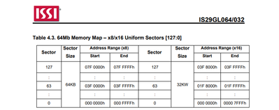

The datasheet says there are 128 sectors with 32KW, meaning 37627 (8000 in hex) locations for each sector.
Is it ok to set address location as multiples of 0x8000 in erase block function for sector erase? Or something else need to be included in code ?
Thanks
2023-08-03 12:12 AM - edited 2023-08-03 12:16 AM
32 KW = 64 Kbytes = 0x10000
FMC maps the NOR so that even in 16-bit mode it looks to the CPU "normally". 64 Kbytes sector occupies 64Kbytes in the FMC address space.
