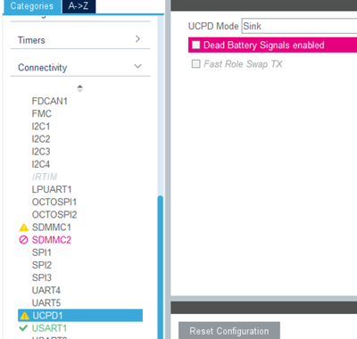

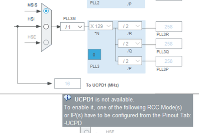

@OlivierR Problem solved! What was missing was HSI clock activation - UCPD depends on it.
I believe it is a CubeMX bug. STM32U5 UCPD is clearly enabled, but CubeMX does not think it is enabled and probably for that reason it does not configure HCI clock. This does not happen with STM32H5. It indicates that CubeMX QA process may still have space for improvement.
