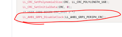

2023-08-24 6:35 AM
> LL_AHB1_GRP1_DisableClock(LL_AHB1_GRP1_PERIPH_CRC);
This disables the CRC clock. Don't do that until you're done with it.

> I dont disable the clock until i have finished the calcs.
This disables the clock after initialization, no?
