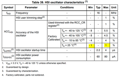

Yes, absolutely. You're seeing an error of 1.9%. Let's check the datasheet for the HSI:
So it guarantees ±1% at ambient before part is soldered. Soldering will change that some. You can adjust the HSI using HSITRIM to get it more accurate.
If you need good accuracy, crystal+HSE is going to be much more accurate.
Also be aware ARR is preloaded and there's probably better ways to do delays, but that is a side issue.

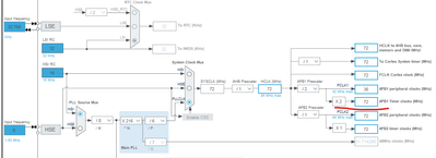

2023-08-26 1:45 AM - edited 2023-08-26 2:13 AM
True, but in CubeMX settings i can see APB1 clock settings different as well as Timer clock settings on that bus different
Thanks, the solution worked for me, but can you explain what does APB1 Timer clocks and APB1 peripheral clocks mean, like how are they different.
