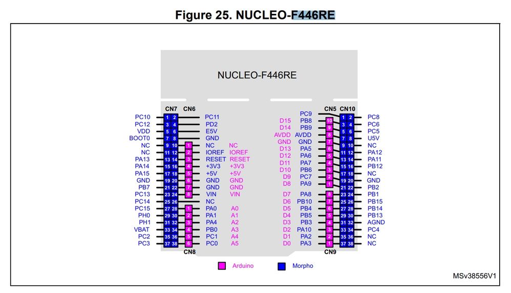

So, I'm trying to connect the u-block neo6m to my STM32F446RE. The thing is when i'm trying to see datas with PuTTY, i get nothing. I'm new to this kind of things so I'm for sure forgetting something. So here are all the informations :
NEO6M ----- STM32F446RE
GRND on GRND
VCC on 5V
TX on D2 (PA10)
RX on D8(PA9)
These connections seems to be the right connections following user manuals and dashboard and all... :

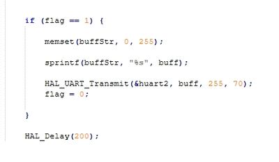

Currently using HAL_UART_Receive() which is a blocking function, and then clearing interrupts.
You can't use string functions on reception buffers directly, there needs to be NUL termination. ie buffer[700] = 0;
It's perhaps preferable to process NMEA sentences a line at a time, using the '$' to resynchronize the buffer, and recognize <CR> and/or <LF> to terminate the line.

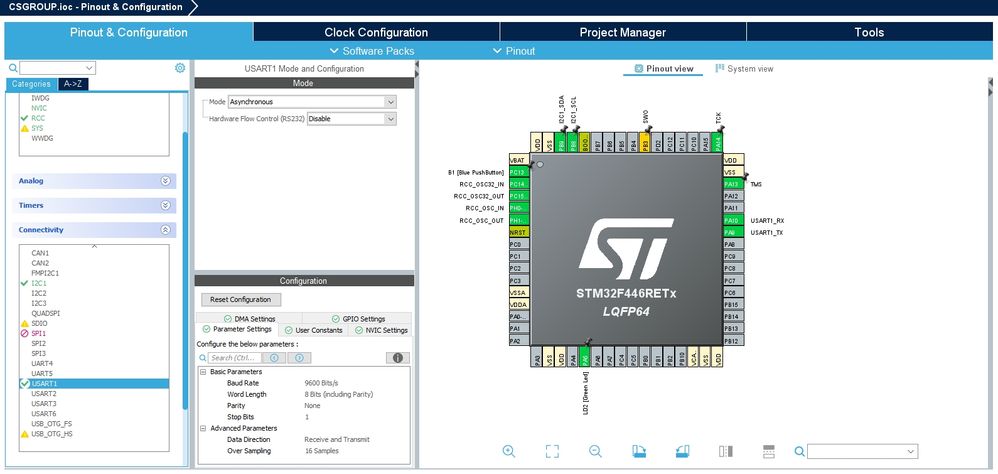

So the NEO6M is using UART1 for Receiving/Transmitting. Then you want to use Putty to see what the NEO6M is sending?
I assume you want to use the VCP which is on UART2 to show data from the NEO6M using Putty? But you haven't set up UART2 because your screenshot shows PA2 and PA3 are not enabled.
In your code I see that you receive from UART1, but I don't see anywhere in your code that you try to transmit on any port?

So this morning I corrected all of the points everyone here pointed out and take into account all of your advices :
- UART2 was indeed not set up.
- UART1 was disabled at some point I don't know why (though it was but I corrected it).
