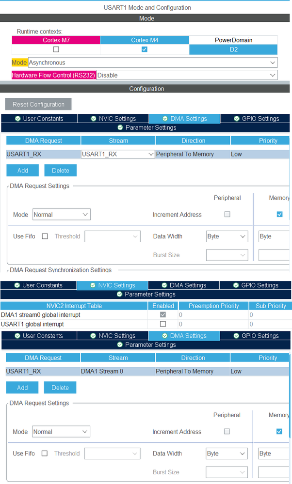

This is my UART1 configuration.
I tried both enable and disable the UART1 global interrupt but it is not work.
I already checked the NVIC2 which control the interrupt for CM4 to make sure that the UART1 global interrupt and DMA interrupt are enabled.
What about the interrupt priority? Which priority should I set?
Thank you
2023-02-23 9:53 AM
You should enable USART1 global interrupt.
It is important to consider the priorities of the interrupts. Depending on your application, while the processor running in the handler mode multiple interrupts, you can set the priority of each peripheral to preempt or be preempted.
2023-02-23 9:59 AM
I already enable USART1 global interrupt but result still the same.

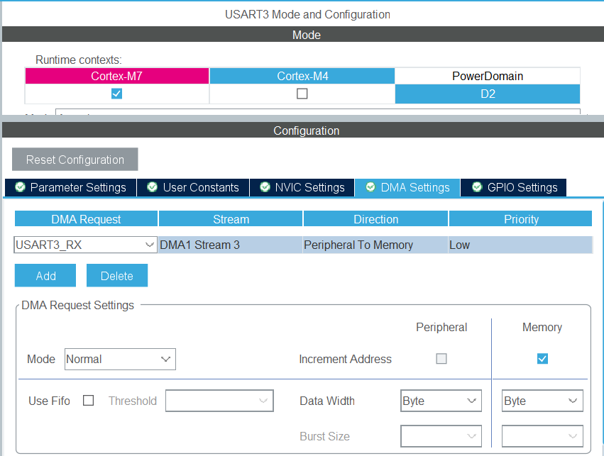

2023-02-25 7:53 AM
This is my UART3 configuration. I still cannot get the correct data.
For UART1, after I changed from the CM4 to CM7, it can get into the HAL_UART_RxCpltCallback function. But the data from DMA is wrong same as UART3.
Why UART1 cannot work with CM4 but work for CM7 even the data is wrong but at least the interrupt is handled.
