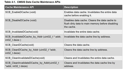

How does your design take into account cache coherency & data buffer alignment?
2023-07-22 12:13 AM
It doesn't because I don't have to? I'm using an F4 which doesn't have a L1 cache. As far as I know it only has a D- and I-cache for flash memory access. Please correct me if I am wrong or if I didn't understand the concept.
The data buffer contains 32 bit floats. I double checked in the memory viewer during runtime that the buffers are aligned and not overlapping. I also checked for wrong array boundaries, but everything seems fine as well.
Thanks!
2023-07-22 1:00 AM
@JP_ama, I am afraid you are correct and therefore I am not. Should have known as last week was investigating STM32F407 SDIO and therefore D-cache is flash only as stated in RM0090. Had some problems long time ago with STM32H735 where DMA did abnormal things from time to time related to cache coherency.
