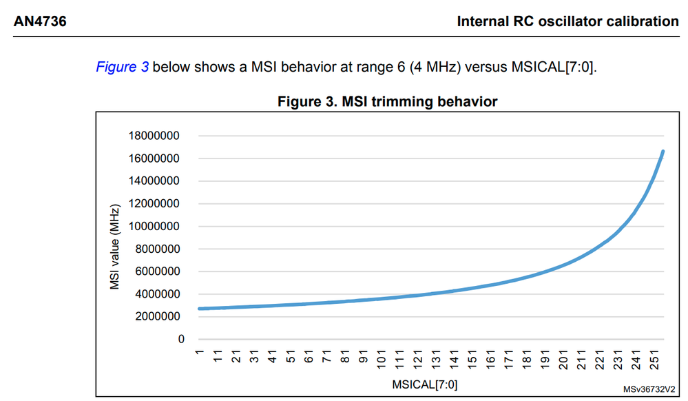

Is there any instruction how to adjust calibration value ?
As to "dongle" - it is USB to TTL serial cable.
2021-09-08 7:08 AM
It is nonlinear, you will just need to adjust and verify. Note that having MSICAL + MSITRIM >= 256 will cause it to overflow and decrease the effective value. So it is possible to adjust both up and down.
