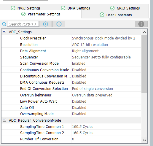

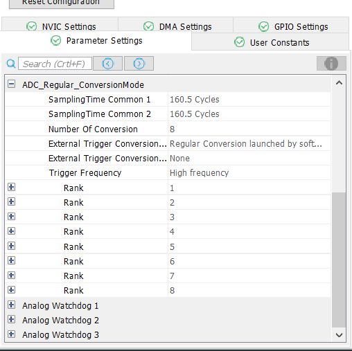

I'm trying to read 9 ADC inputs on the G070 MCU using the interrupt method. Unfortunately, under the number of conversions setting I can only do 8 conversions.
Is there a way around this?

The sequencer (choosing an arbitrary order to convert channels) is limited to 8 channels.
Disable the sequencer and you can convert as many channel as you have selected. Channels can be converted in forward or reverse order.
DMA and IT have the same limitations here. Switching to DMA won't help.
