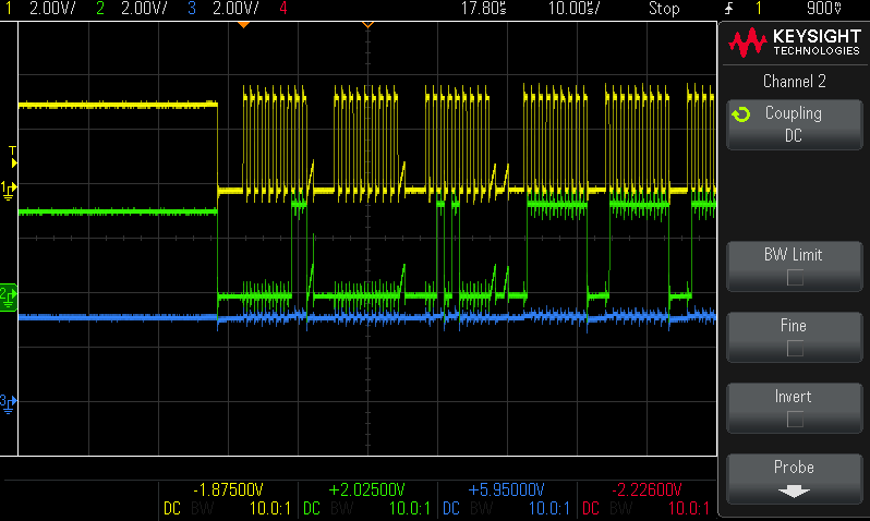

I'm facing an issue after configuring the SPI1 of STM32G491REI6 MCU using STm32CubeMX for SPI_DATASIZE_8BIT. I have captured the signals on the Oscilloscope after Transmitting the followed three-byte (0x03, 0x00, 0x50) from master(MCU) to slave. you can see clearly in the image for each byte transmit MCU is generating a clock two times, which is undesired. Clock (Yellow) and data(Green)

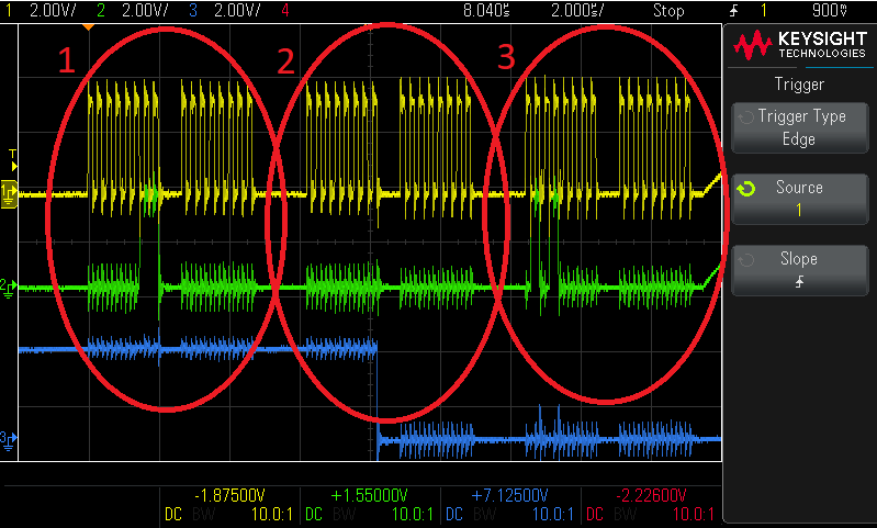

For SPI_DATASIZE_9BIT is working fine, see the second photo.

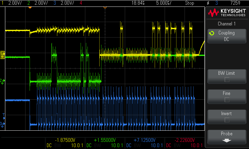

I have tested the same code SPI_DATASIZE_8BIT for the STM32F446RE MCU and that's working fine, See Photo.
The only issue is with STM32G491REI6 using SPI_DATASIZE_8BIT. Please provide the scalable solution as per the mentioned query.

2021-09-07 5:58 AM
Show the code you're using to write the data to the SPI.
Possibly you're using a 16-bit instruction, so sending two bytes instead of one. The G4 has a FIFO here whereas the F4 does not.
