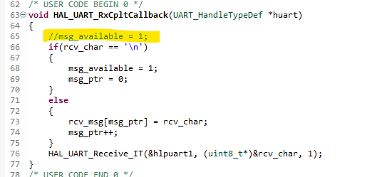

Your code you've posted is working on my Nucleo-G431B just fine.

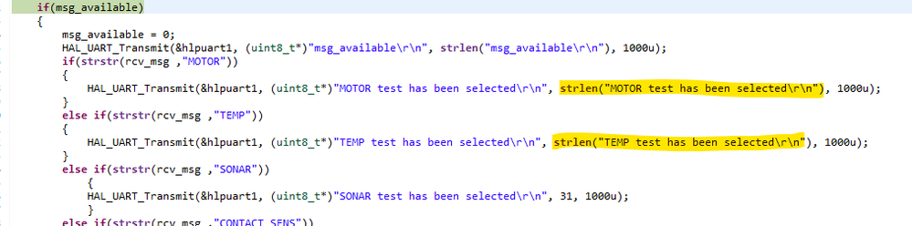

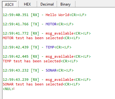

With the exception is that you should use strlen instead of guessing the length of the string. I was getting some null characters when i sent SONAR.
Also remove the flag as i was getting double "msg_available"

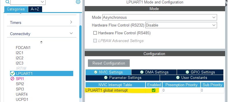

Now you're probably wondering why I was able to get your code to work? I saw the link to the tutorial and nowhere did it mention to enable the NVIC interrupt. How ST left that vital information out is beyond me?
