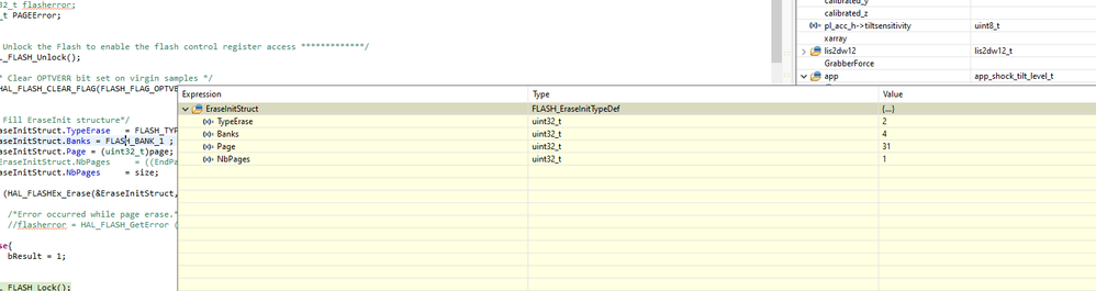

on the occasional times i was able to generate this while i was debuggin i got these data :
The HardFault happens in HAL_FLASH_Lock(); ->  SET_BIT(FLASH->CR, FLASH_CR_LOCK);
before we enter the HardFault  i see this data in the flash_erase_pages function.
PAGEError = 2103
PAGEError = 536876972 (another time)
Which seems to make no sense as there are only 32 pages.
flasherror =  0
Upon a successful flash write, the value of PAGEError is consistently 0xFFFFFFFF. I'm perplexed by what might be causing this unexpected behavior.
Here's the structure of EraseInitStruct for your reference:

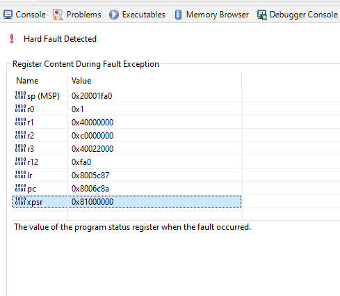

The hardFault triggers at HAL_FLASH_Lock(); Line 31
I have captured some registers and see this :
pFlash.ErrorCode contains value = 0xe0 , and tripple checked all possible causes of the error bits (PGAERR , SIZEERR  and PGSERR ), but found nothing.
Any other idea's what i can do to find the problem?

Look at the disassembly at and around 0x08006C8A to see the exact statement that causes the fault.
Look at other relevant registers to determine more information about the cause of the hard fault. STM32CubeIDE has a fault analyzer, would recommend using that if you are unfamiliar. See "7.2 Using the Fault Analyzer"
https://www.st.com/resource/en/user_manual/dm00629856-stm32cubeide-user-guide-stmicroelectronics.pdf
Yes, does kind of seem like something is blocking, or breaking context in the background, and something is getting corrupted. Perhaps disable / enable interrupts at a level out here, see if you can move the failure
Have a fault handler that outputs the MCU register, both the general and those holding the faulting details. Interest to see the memory address it's failing on, not the code address, but the read/write memory address it's acting upon.
every time, also with irq disabled. i go trough the Fault Analyze part right now
