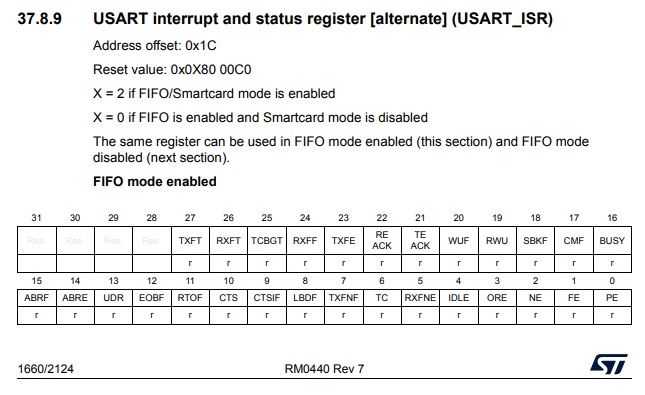

2023-10-30 7:44 PM - edited 2023-10-30 7:47 PM
Here's the Reference Manual, explains the bit flags. The 8 (bit 3) is the Overrun Error
2023-10-31 1:34 AM - edited 2023-10-31 1:34 AM
Ok but what can be the root cause ? I seems to be a software, as I uderstand it. (SO it does not explain why it is working on the nucleo board)

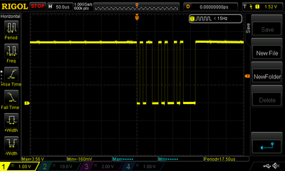

2023-10-31 2:20 AM - edited 2023-10-31 2:28 AM
> There may be noise, e.g. if you connect connectors, or there may be bad ground connection... Oscilloscope is your friend.
Here's a picture of the signal received on RX pin.
Signal seems OK.
> If you observe the UART Rx data register in debugger, the RXNE flag gets cleared...
I don't get into the interrupt handler with only one char and without debugger
