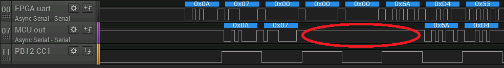

GPIO_ToggleBits(GPIOD, GPIO_Pin_12); } }Bellow is a logic capture on the RX (fpga side) and TX(to the pc side) of the uart2

void USART2_IRQHandler(void){if(USART_GetITStatus(USART2, USART_IT_RXNE) != RESET)//enter interrupt when STM32 receice data.{ t = USART2->DR; ss[0]=t;USART_puts(USART1, ss); // SEND 1 byte via usart1

}}I also added a GPIO toggle (''PB12'') from the picture bellow just to see where i am in the irq
But i am facing another issue, from the logic analyzer screen shot bellow, if the packet contains 0x00 bytes, on the USART DR register when i read it its empty( ''MCU out''). Why?

Ok figgured it quickly... used directly the unsigned int value, without converting it to char... and now its ok
USART_SendData(USART1,USART2->DR);
2017-04-30 11:42 AM
Ah... 0x00 in ascii is NULL.... but how can i add even 00?
