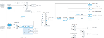

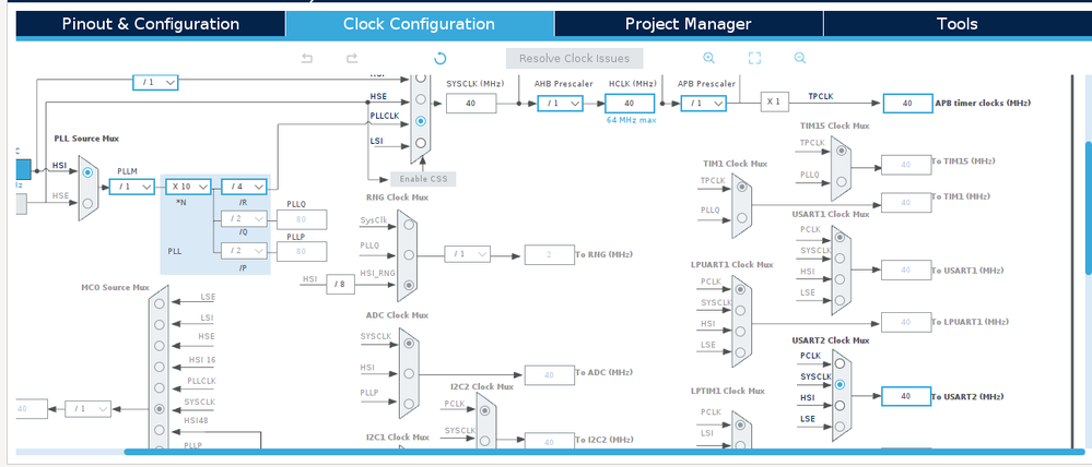

I am using stm32g0c1ret6 MCU board with 40 Mhz for now, to get accurate 2.5Mbps baud rate. but my actual application is on 64Mhz. i have attached the system clock settings and clock config snapshot for reference.

You still haven't given any details of your hardware!
@Rohit007 wrote:I am using stm32g0c1ret6 MCU board
What board, exactly?
Your clock setup is using HSI.
Internal RC oscillators are rarely a good choice for UART comms - especially at higher speeds...
You didn't answer how you are testing this.

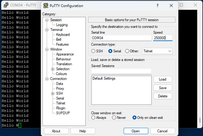

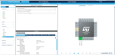

hello @Rohit007
can you specify if it's a ST board or custom board and what serial monitor are you using?
because I tried replicating your case and honestly, I didn't encounter any issue
it worked fine. So, can you provide more details?
I'm going to attach some screenshots if you want to compare with your own project or maybe if you want to replicate it.

Hope that helps!
