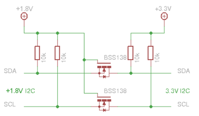

2025-12-08 1:09 PM
So invest 20 ct and use a standard circuit, for level shifting:
2025-12-08 1:29 PM
Thank you for the quick response. However, reducing the area of the PCB is the driver for this design. I'm familiar with the NXP PCA9517 to shift logic levels on I2C, but I need to reduce board size wherever I can.
The 4000+ page manual (RM0486) is well written, but the section for I2C doesn't specify which power supply pins set the logic level. I assume that it is the VDD pins I have tied to 3.3V, but wanted to verify.
