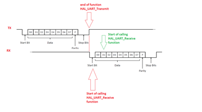

Like there are two starting HAL_UART_Receive, the red one is ideal that it if fast enough after transmit function that it starts waiting for RX flag in the starting bit of RX but what if function is slower and the call of HAL_UART_Receive end waiting in the second bit out of 8 bit of the receive data ? Dunno how fast this function is interpreted, probably the red one is ideal for the speed 9600, because it is 1ms and the function to read (HAL_UART_Receive) takes couple ns so we have like less than 1 ms spared time before the full data comes I guess, but for faster baund speed dunno.
But like I said, I don't know why Receive must be called before data appears when I don't know if it fully appeared after HAL_UART_Transmit or not, usually in simple examples people call HAL_UART_Receive after HAL_UART_Transmit, but maybe data already appeared in RX line while calling HAL_UART_Receive so it doesn't make sense + there is this DR register to hold this 8 bit word for some time.

What you wrote above applies to so called half duplex mode, when only one side can send and the other side must listen. There indeed are systems that work in this mode (think RS-485).
But often the UART is used in full duplex mode, when both TX and RX directions work independently at the same time. In this mode a device (such as a modem) can echo back received characters immediately after receiving them. The red vertical line on your picture that separates receive from transmit simply does not exist. They overlap. Will your code snippet work in this case? (Surprise! it won't). Therefore you have to start at least the receive process "in background" so that it won't wait for transmit. Again as Mr. Kostka wrote, the functions to use are non-blocking HAL_UART_Receive_IT or HAL_UART_Receive_DMA - but the latter has complications (the timeout thing, TL;DR) so eventually people write their own interrupt driven receive code. If this still does not make it clearer... just have a good nap, drink more water and search for more full-duplex examples.

But if both TX and RX are sending at the same time then yea my code won't work because the assumption is that after sending the TX command the device will send data after receiving the full command, so after receiving full data it sends back data in the other lane. That's why there are two lanes.
My questions were partly answered, I wondered just that if it worked like in my diagram which I believe some work like that. At least the Bluetooth worked like that I guess. Because I wrote the same code like in the examples I gave.
I didn't know how to ask the question. Because it might be just to specific. I wondered if just the function is fast enough to be before the RX flag is ON, like in the picture.
I just interpreted that maybe this HAL_UART_Receive in that diagram picture, the call itself is fast enough to wait for RX flag before 1ms passes for 9600 baund rate because the function maybe takes like ns to be executed so 1ms - some nano secons = couple of micro seconds, still some time to spare. For higher baund rate I dunno maybe the function is still fast enough to be ready for RX flag before the whole data is sent to the DR register.
