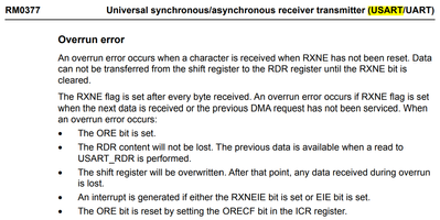

-> What if I have a RX buffer that is full ? The flag is on and I didn't read the data. Then the new data comes after sometime, will it overwrite my data and still the flag will be on ?
The data is not overwritten. The new byte is lost and the ORE flag is set. The ORE flag must be cleared before the peripheral starts working correctly again.

-> I tried to read from manual but like in the picture you've sent, it says that it has shift register and RDR register I didn't much understand why there were two registers and it says that during the ORE the shift register is overwritten and that data is lost hmmm so the RX is not disconnected and the data is still received by the shifter register but not by the RX register ? There are also so many flags that I at some point get lost in what is what and what should I think of and what not.

Peripheral registers are not "memory" but a window into logic and state-machines.
There is a shift register in the background, once it is full it gets moved to the receive data register, if that is empty.

It's ORE in both cases. Same flag, same bit, just a typo in my response. (The overrun flag is called OVR on other peripherals, not sure why it's called ORE here instead.)
-> So when ORE flag or OVR flag is set then Receiver perihperal doesn't take any new data (the register that takes bit after bit won't take any data so RX is disconnected) ?
Effectively, yes. The actual behavior is a little more complicated. There is a shift register, and that keeps getting updated, but the data never makes it into the DR register. The RX pin is never disconnected.
You don't have to understand the low-level hardware architecture to start. It sounds like you plan to use HAL. There are UART examples in the CubeMX repository, that's a good place to start. Consider connecting RX and TX (i.e. loopback mode) and verifying you can receive what you're sending.

>"Effectively, yes. The actual behavior is a little more complicated. There is a shift register, and that keeps getting updated, but the data never makes it into the DR register. The RX pin is never disconnected."
Aha so as I thought there are 2 registers !!!
One that is updated and the one that has the actual word. So when ORE/OVR is active then this shift register gets all the time updated but the DR register will not be updated until the ORE is cleared.
