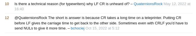

Additionally, it's customary to use CRLF ('\r\n') and not LFCR ('\n\r'). There must be a good reason for that, though now that I'm pointing this out to you I realize I don't know what it is - other than convention.
Update:
da internatz can haz answrz
On teletypes, CRLF amortizes the delay of a CR operation (moving the head back across the width of a page) over two bytes, while LFCR doesn't. ...and here we are with TFLOPS in our pockets still blindly obeying history.
