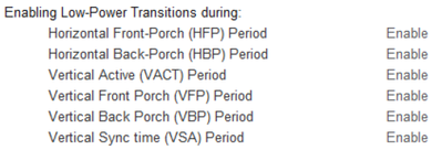

LP transitions are enabled for all video areas.
16 Byte command maximums
Commands are transmitted in Low Power mode

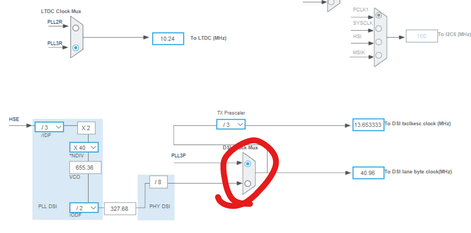

Clock and other parameters that seem potentially relevant (same for both platforms generated from CubeMX):
PHY DSI 240MHz
DSI lane byte clock 30 MHz
DSI txclkesc 6 MHz
Automatic clock lane control is disabled (per the U5 Errata)
PHY Low Power offset 0 CLK
BTA is enabled

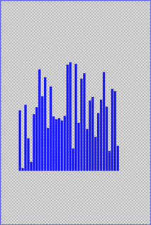

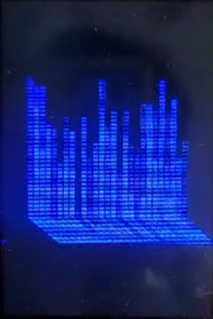

We managed to get something partially displayed (1/3 of the display has the image warped by 45 degrees) using the CubeMX configuration but it's really flaky: as soon as the content in the framebuffer is changed - e.g. adding different colors, drawing on different areas - the result spans from being worse to completely broken (blank display).
The picture shows the best result we could achieve, and how it should look (the bars' height dynamically changes over time so they don't match 1:1)

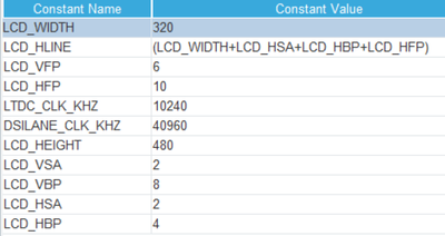

2024-02-19 5:23 AM
I just wanted to update the thread because we managed to have something displayed. It still has some bugs (but that could be related to other issues not strictly related to the U5 or the controller).
We started with an example from the TouchGFX which was also based on RGB565. We made some changes according to the controller pseudocode given by the display supplier and some hit&tries.

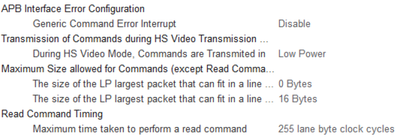

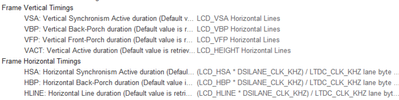

The crucial parts were the following:
Tell me if this helped you somehow.
Cheers
2024-11-05 5:28 AM
Did anyone figure out why PLL3P needs to be used and PLL DSI is not ok?

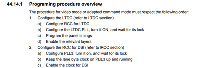

2025-04-24 9:46 AM
There are no issue with the PLL DSI within the RM0456, section 44.14.1 "Programming Procedure Overview," the MIPI clock source should initially be set to PLL3 then switched to D-PHY PLL
