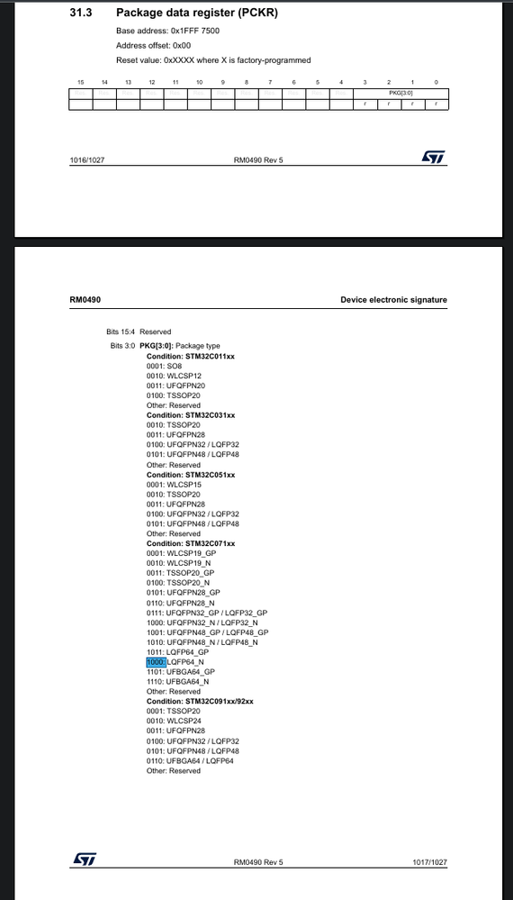

On page 1017, Section 31.3 in Package data register of the STM32C0 reference manual (Revision 5), looking at the PKG[3:0] bitfield, when the condition is STM32C071xx, there seems to be two parameters with the same value? Was the value 0b1100 intended over 0b1000? (Since both "UFQFPN32_N / LQFP32_N" and "LQFP64_N" are 0b1000). See below for the referenced page.
2025-04-10 5:53 AM
Got the confirmation that indeed for LQFP64_N the PKG[3:0] value is 0x1100.
It will be fixed in the next coming revisions of the reference manual.
Thank your for your contribution.

Hello @ivanmak ,
I will check internally and get back to you asap (internal ticket 207318 not accessible by the community members).
Thank you for your contribution.
2025-04-10 5:53 AM
