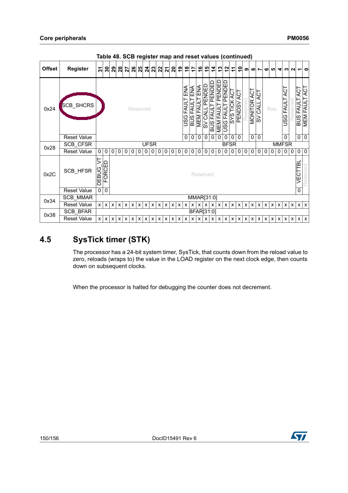

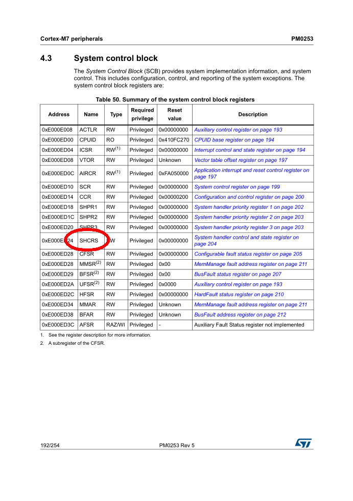

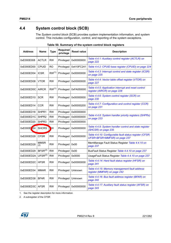

Hello @Community member ,
Thanks for bringing this to our attention.
Typos confirmed and raised internally for fix.

Thanks, Imen.
I noticed, that the same typo is in ARM's template documents, too...

Just ran into this typo again in Table 50 of PM0253 Rev 5. That's the same page and revision that was reported 4 years ago. Seems like we're due for a Rev 6.
Would recommend ST search through all their docs for the "SHCRS" typo.
